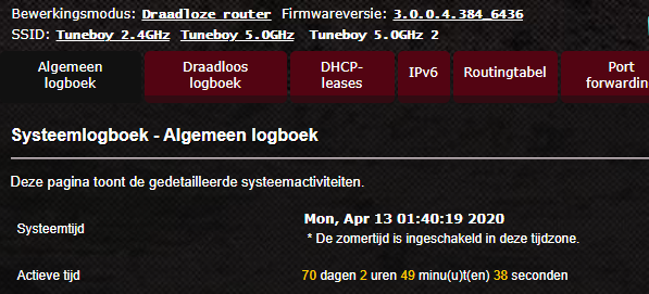

This is the most stable router i have ever had. Look at my uptime! 70 days without a singele reboot and it is still going. Ofcourse i am still on the 6436 firmware version. As i read the newer ones are horrible. That is why i dont update my router with latest firmware. Everything is working as i want to so no need to update.
You might consider updating for Fixed CVE-2019-15126 (Kr00k) vulnerability which is a very nasty vuln.
I might yes but i wont lol. As long as there is no stable future firmware i wont update. Its all running the way i want so i dont wanna f*ck it up by throwing garbage firmware on it.
