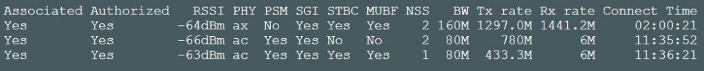

For data point, do you have channels 100-128 for 160MHz, or just 36-64?
I have both available. See the attachments.
I originally hard coded the control channel to 36 but the router took over and changed that setting to AUTO and set the control channel to 48.
The second attachment is to correctly format the last three lines of the first attachment.

Oh, thanks for the data point! So Australia is similar to Canada. The log shows that you're missing 120-128 so 160MHz on 100-128 will be unavailable.

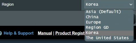

As I indicated in post #77 I have a selection for a country on the Wireless / Professional page. Australia is not one of those selections. See the attached image.
I tried some of the selections other than the default and I now have channels 120 to 128. I bought my router from Amazon Australia and it came with Australian electrical equipment.
Am I being naughty by using location settings other than the default? I live about 50km (30 miles?) from the nearest airport.

As far as I can see from this document Australian spectrum rules are the same as the Europe (power and channels). So unless I've missed it channels 120 -128 and 149 - 165 are not allowed
Thanks for that info Colin. I read the document and I'm not any more wise now than before I read it. However, I'll switch my router back to the default setting.

I held off updating this thread until I had the actual replacement at my home before providing a final outcome to my trek here. After tons of back and forth with support and finally the CEO interface to report feedback on how support did, it was determined they could not resolve my issue and didn't have a resolution for it. They are dead set in stating that they can not/ will not offer any kind of one time firmware updater to convert from region to region.
In the end it came down to doing a router exchange. They offered up a RT-AX89X as a replacement because they could not locate another RT-AX88U, but after review I turned it down since the chipset most likely wouldn't ever support a Merlin upgrade if I wanted to go that route. I figured....swing for the fences and asked if I paid the difference could I get an GT-AXE11000 as a replacement? I was told they don't do cash transactions for RMA things like this.....so it was left with.....we will ask if that is possible for an upgrade path, search again for another 88U, if not then I'd settle for the 89X.
Turns out the agreed to the GT-AXE11000 upgrade and it was delivered yesterday. I am happy with the overall results and I have an AX210 in my laptop which will support the 6E 6GHz connection.
