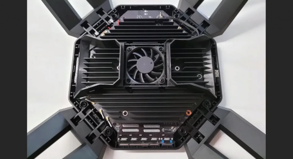

Hello everybody.
Today I've made the hardware mod and closed the router.
The following picture speaks more than words:
In a very few words:
  • I changed all the termal pads, with ARCTIC 1,5mm ones. When necessary I used just the 1,5mm one, otherwise two stripes of 1,5mm for a total of 3mm
  • Solely for the CPU, 1,5mm copper pad + 1,5mm thermal pad.
In my opinion RF ICs temps could be even better if I used some copper even there.
Hence, IMHO, all these temperature issues are an hardware problem.
