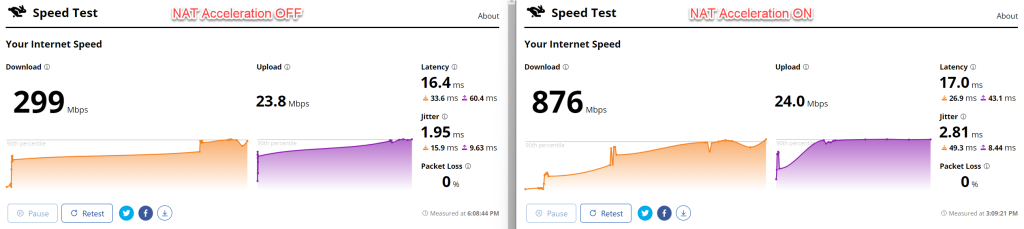

Upon further testing, I've realized that enabling NAT Acceleration significantly boosts my download speeds up to Gig levels. This contrasted with a maximum of 300 MBPS when NAT Acceleration was disabled. However, this leads me to a predicament - I'm caught between a rock and a hard place. If I enable NAT Acceleration for faster internet speeds, I end up with the persistent problem of my AiMesh Guest WiFi not having internet access when intranet access is disabled.
On several other threads, I've noticed discussions suggesting VLAN adjustments on managed switches as a potential fix. However, this doesn't apply to my environment since I don't have any managed switches in the network paths of the nodes or router. Moreover, if VLAN alterations could provide a solution, I'm puzzled as to why the main router's Guest WiFi would still encounter the no-internet-access issue. It leads me to believe that the problem isn't solely due to the nodes, but affects the main router as well.
I'm at a bit of a loss as to how to resolve this. Any insights or suggestions would be hugely appreciated. At this point, I'm seriously considering abandoning my Asus setup due to this conundrum. Thanks in advance for any help you can offer.

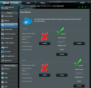

I'd like to provide a brief update on how I solved an issue with my guest Wi-Fi not connecting to the internet. Initially, the problematic configuration was as follows:
  • NAT Acceleration: Disabled
  • Guest Network 1 Access Intranet: Disabled
My initial workaround was to enable NAT Acceleration, which successfully provided my guest devices with internet access. However, this resulted in a limit to my internet speeds, approximately capped at around 300.
Based on suggestions from others, I found a solution that involved reconfiguring my guest Wi-Fi networks, specifically Guest 2 and Guest 5. I moved Guest 2 from the first column of the Guest Network settings page to the second column, and Guest 5 to the third column. This change enabled me to set NAT Acceleration to 'Auto'. Consequently, I was able to enjoy Gig download speeds again.
This configuration change allowed devices on my guest network to access the internet while remaining isolated from my primary internal network.
I hope this solution proves useful to others who may encounter similar issues. I spent quite some time figuring it out, so I'd like to thank everyone who offered their assistance!
