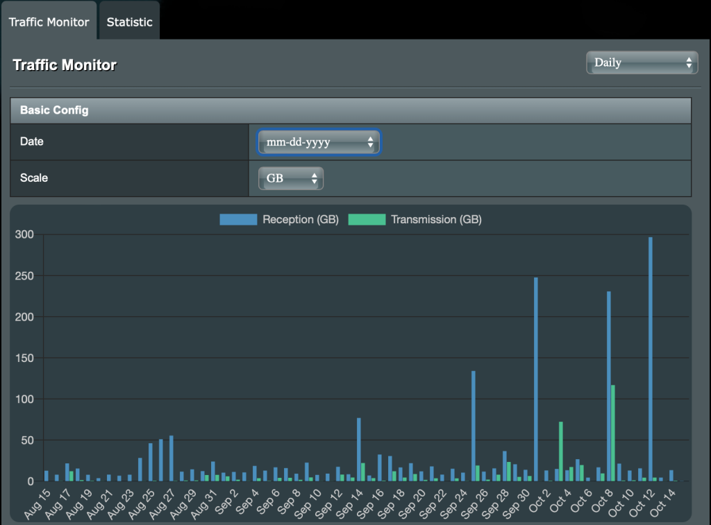

RT-AX88U maxing out a core and regularly showing 60+ MB/s upload

I've been having the same problem for a few weeks now on an ASUS RT AX86S.
After restarting for a few hours, the drive is always fine. Subsequently, an upload of 85-135 MBps will begin to appear, the speed from the provider is only 30 MBps. During that time, the CPU load will increase a lot. (HSSD process approx. 50%) followed by internet outages. the outage is for about 10 seconds, the whole thing repeats itself after about 5 minutes.
The traffic is generated by the router, no device on the network behind the router.

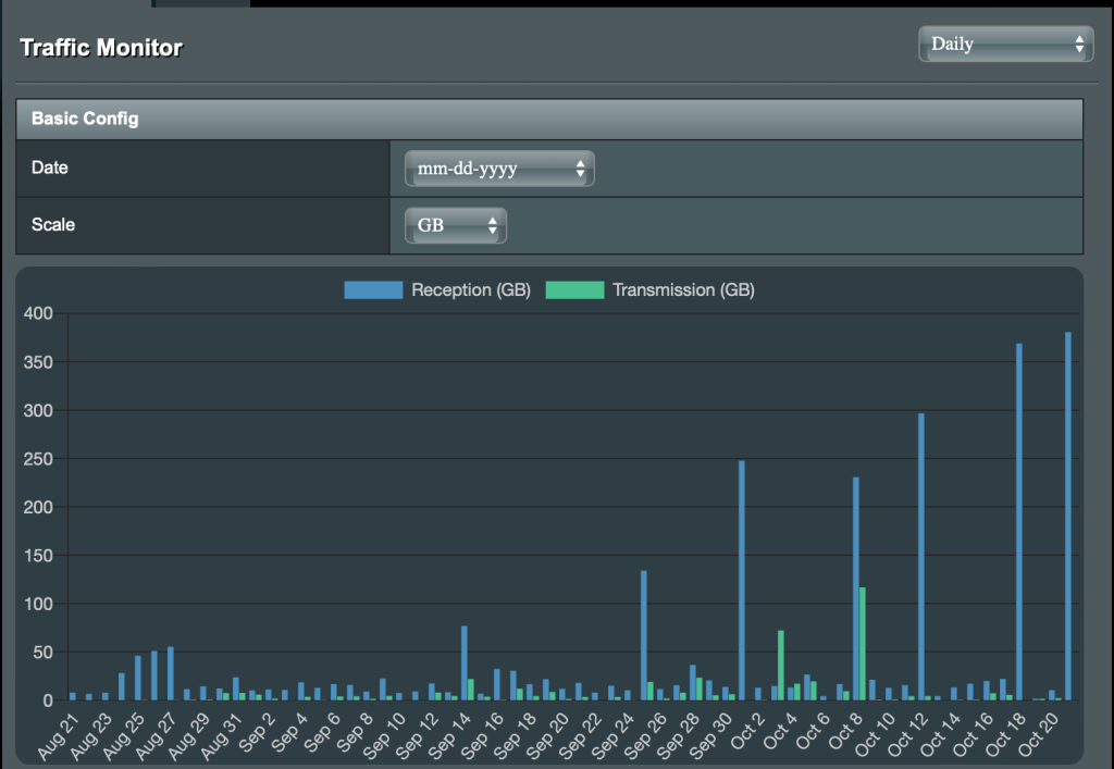

It's happening again on my RT-AX86U with merlin.
Had 5 days or so all fine. MY azure vpn for work started shutting down on me and then saw the traffic on my wan again!!
I have now just changed my password again, turned off ddns, openvpn also.
Any other suggestions?
Thinking of getting a new router/firewall today (microtik or tplink omada) as I work from home and need to fix this asap.

I have an RT-AX86U bait running on latest stock available Asuswrt 388_24243 from May 2024. Let's see what happens.
@jd24 Your router doesn't appear to be infected at the moment. Have you rebooted the router since you last saw the problem?
Also, you do appear to have AiCloud enabled despite what you said earlier. Can you check again please?
Yes I have rebooted and strengthened my password.
Sorry when you said AICloud I thought you meant the Cloud Disk option and AICloud Sync
I have smart access enabled only.
Should I disable this?
I have switched all options off now
Many thanks
Here is what mine looks like:
I was out of town this past weekend and came back to see another spike below, even though nobody was home. I've checked everything mentioned here and see nothing that might be causing this. I don't know if this is actually happening or if it's a glitch in the Traffic Monitor, which I know has happened before.
My spikes today weren't a glitch. I check my isp app and it displays the amount of GB's used and see big jumps!!
Changed my password again, even stronger, rebooted and switched off ddns again.
Will rely on twingate for access (hoping this is still secure)
