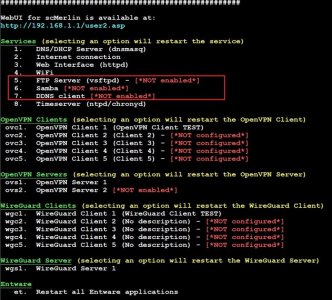

1) FIXED: Added code to check if the DDNS service is enabled before restarting it.
2) IMPROVED: Added code to the SSH CLI menu to show if Samba, FTP, and DDNS services are enabled.
3) Miscellaneous code improvements.
** The fork from @Jack Yaz's scMerlin add-on is now hosted on the AMTM-OSR GitHub repo:
