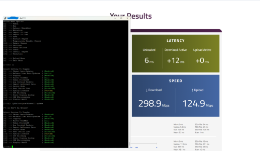

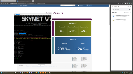

Can someone have a look at the attached screenshot and indicate whats's going on and suggest any methods to resolve this please.
Is it possible that the outdated merlin f/w (FW Version; 384.19_0 (Aug 14 2020) could be causing this?
Also, Option 10, [10] --> Update Skynet: fails.
Thanks in advance,
Unk
[*] Lock File Detected (start skynetloc=/tmp/mnt/Asus-entware/skynet) (pid=19191)
[*] Locked Processes Generally Take 1-2 Minutes To Complete And May Result In Temporarily "Failed" Tests

It certainly doesn't hurt getting up to date on the latest and greatest. My skynet will give me the same messages at times after a reboot, or after forcing a major reset of some kind, but they will eventually resolve themselves after a minute or two. Are yours not resolving?
When picking option 10, it asks to check for new updates, and upon hitting option 1, it says I'm still up-to-date. Where does it fail for you? You can also try running this command:
/jffs/scripts/firewall update

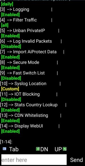

Hi Guys. I am trying to make a head and tail out of these stats. as soon as I restart Skynet its changing the syslog location to custom.
also its showing some locked file detected. i can change location back to default again but why its changing it after restart !!
can anyone please shed a light on this.
only modules I am playing around with right now are AMTM, Diversion and Skynet.
my main module which I love is built in cake but however I wanted to expand my exploration into other modules too.

Do you have Scribe installed? If so, that might be why the location keeps changing to custom. I cannot think of any other reason why this would be changing.
Thanks For reply. only modules I am using are attached. I never installed scribe.
I did modem reset and USB format on PC and than in router and than with USB module using FD command.
reinstalled Skynet. but same issue. after restarting Skynet syslog location changes to custom.
only module I am running now are AMTM- Skynet and Format Disk.
Yea, I am not sure myself why this is the case. I looked at the script code. It might be intended behavior because this option behaves differently between old AC router models versus the newer AX models. Maybe @Adamm or @dave14305 can look into this if they get the time.
    if ps | grep -F "/sbin/syslogd" | grep -qF "/jffs/syslog.log" && [ "$syslogloc" = "/tmp/syslog.log" ]; then
        syslogloc="/jffs/syslog.log" # Fix syslog location on newer random models
        syslog1loc="/jffs/syslog.log-1"
    fi
This was intended at the time to get around what appeared to be random models now having a new default syslog location in /jffs/syslog.log... Is the issue that is says custom in Skynet?

You can stop fretting over it. It’s not a problem. Skynet considers any log location other than /tmp/syslog.log to be custom. Newer routers use /jffs/syslog.log. Hence “custom”.
