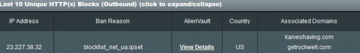

I've been noticing Skynet has been blocking valid (legitimate) sites as fake sales recently. These two are just a couple (I believe cloudfront). So where is this information coming from to determine what's being blocked. I'm assuming it's IP based so I'm going to have to whitelist domains, correct?
karveshaving.com, getrockwell.com
Interesting (from my amateur point of view). I tried the 2 sites you mention above, and could get to neither. They show up as Outbound blocks in my stats. The blocking list in their case appears to be "blocklist_net_ua.ipset". Clicking on that list in the stats page leads to this explanation (which I don't understand from a technical point of view).
Interesting (from my amateur point of view). I tried the 2 sites you mention above, and could get to neither. They show up as Outbound blocks in my stats. The blocking list in their case appears to be "blocklist_net_ua.ipset". Clicking on that list in the stats page leads to this explanation (which I don't understand from a technical point of view).View attachment 24681
Correct. It looks like it’s all the one shared IP address for a bunch of e-commerce sites. While some may be legitimate (confirmed folks purchasing from these two sites), some of the others were spam or malware. I added the karve domain to the whitelist and it whitelisted the IP. To Since Skynet is totally IP based, adding the karve domain on my end also opened the Rockwell site. I was hoping to just allow the sites without allowing everything, but I’ll let my AV and script blocker deal with that issue.

IMO the list of default lists includes some lists which have these false positives, and which gain new false positives every couple of days (lists are dynamic after all).
i removed 2 of the default lists and stopped getting any false positive issues (for the past 1 month).
Can you remind us which ones you removed please? TIA...:)
My current exclusion list: blocklist_net_ua.ipset|firehol_level3.netset
basically those 2 lists above separated by the pipe character
but that's how you enter multiple lists in the Skynet script menu anyways :)

Thanks. I just saw that somehow 1.1.1.1 was added June of this year to firehole l3. If that kind of crap is happening with that list, how can it be reliable and include as a standard list in Skynet?
Don’t get me wrong, I know many of these are user supported lists but that’s not good.
Also looks like there was a big update for the blacklist one today (50 added, 49 removed).
I'd like to remind users I don't maintain any of the example lists provided, these are merely there to guide users on compiling filter lists to suit their own needs. Personally I use these example lists and rarely run into false positives.
Unfortunately due to the nature of shared hosting, it only takes one bad domain to get an IP blacklisted for web-servers that potentially host thousands of websites using the same address. This is a fundamental issue entirely outside Skynet's control, we provide IP banning functionality, not content.
Now with that being said, if users believe the quality of a list has dropped for a significant amount of time (with examples!), we can discuss removal of said list from the examples provided.
If the above user's example of "1.1.1.1" being added to firehol_level3 is indeed verified ... that is quite egregious ... considering that 1.1.1.1 may actually be the default (or at least the "first on the list" / "recommended") DNS-over-TLS server in Asuswrt-Merlin.
I would propose that as a starting point, we consider removing firehol_level3 from the Skynet default lists.
Even if firehol_level3 adds 1.1.1.1 or any of the chosen lists, all anycast DNS ip's are whitelisted by skynet.
