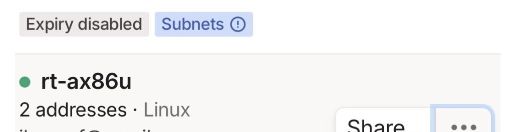

And there is no “may” as far as I’m concerned, getting past CGNAT by configuring Tailscale with a subnet router got me access to my remote device. Love it!
Have to do some reading but currently running on phone and router says connected to tailnet, but stops at that point.

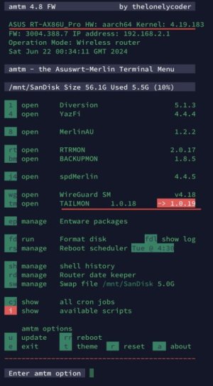

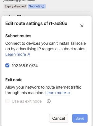

I wonder if it's possible to make Merlin's sshd to accept connections on tailnet0.
I don't want to constantly accept routes from my out-of-home clients unless I need to. I just want to be able to ssh to the router's Tailnet IP. Does anyone know if this is possible without setting the sshd setting to accept connection from all of WAN?

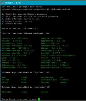

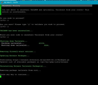

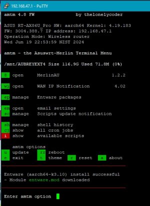

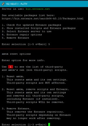

No need! I couldn't let it go, thinking about it overnight, so I decided to (in order):
  1. Completely uninstall TAILMON (which automatically removes the Tailscale entware dependencies); then
  2. Do an entware UNINSTALL. I used amtm's entware removal option 3 i.e. ep, 5, option 3.
  3. I then tested the "tm" (TAILMON) install WITHOUT entware and of course got the (correct) message that TAILMON needs entware as a prerequisite.
  4. I then reinstalled entware (ep, 64bit version).
  5. I then did the "tm" (TAILMON) install and hey Presto, it installed the two entware Tailscale dependencies then went onto the Express Install screen. Brilliant, I am a happy chappy!
So, the lesson for me here is if it gives error messages or does not behave during the install, strip back your amtm by removing TAILMON and especially your entware (ep) and then after the mandatory reboot), reinstall it,
Apologies if you have spent abortive time looking at it!

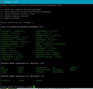

Hi Viktor,
So, the lesson for me here is if it gives error messages or does not behave duringthe install, strip back your amtm by removing TAILMON and especially your entware (ep) and then after the mandatory reboot), reinstall it,
k.

Hi Viktor
Thank you! OK I used option 10 and said yes to uninstalling the Tailscale dependencies as the second part of that option. I then used your curl option for my reinstall; 1.0.19.
It all works fine, as expected, for two reasons (a) you're sooooo goooood and (b) my previous entware removal/reinstall that ultimately fixed my issue.
The thing here is that because I now have a successful entware install, I cannot really tell you with any certainty whether this version 'would have' fixed the old issue. All I can say is "it works as expected!". How do I know it's not just a placebo with an extra version number :) .
I have no idea why the previous one gave me so many issues, even after reinstalling via amtm. It was the more nuclear option of removing then reinstalling entware which is what ultimately fixed it for me, as above.
Thanks again !

Small patch to fix some install/uninstall issues as it relates to entware prerequisites already being in place... thanks to @jksmurf for the heads-up and testing on his end! :)
What's new?
v1.0.19 - (June 19, 2024)
- PATCH:
Thanks to @jksmurf for the detailed writeup on the issues he encountered while trying to uninstall/reinstall TAILMON, along with issues with Entware he was dealing with. After going through the code, it seemed that TAILMON was bypassing the ability to use the express-install method if certain entware prerequisites were already installed. This has been tested and fixed!
Download link (or update directly within AMTM/TAILMON):
SSH works out of the box for me using userspace mode... I can access the router using the router's LAN IP from anywhere safely and securely... and yes, exposing SSH over the WAN is a big no-no.

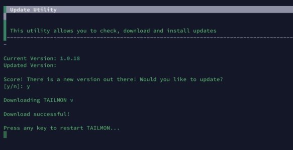

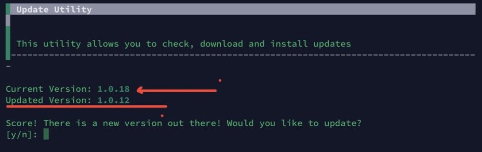

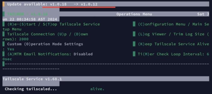

since 1.0.12 where I installed Tailmon manually through
curl --retry 3 "https://raw.githubusercontent.com/ViktorJp/TAILMON/master/tailmon.sh" -o "/jffs/scripts/tailmon.sh" && chmod 755 "/jffs/scripts/tailmon.sh"
I’m only able to update it manually by running the command again
On update Menu it seems it only see 1.0.12 as the current update and suggest me to downgrade to it. Please see pictures. I have held back from updating just in case you needed more info from me to squish this bug.
It seems the versioning file is stuck, or read-only or something... how about try to delete this file:
rm /jffs/addons/tailmon.d/version.txt
Then go back into the update menu item, and check again? It should recreate the file using the latest available version visible on github.
I’ve deleted the file which’s contents were 1.0.12
Update showed empty updated version. I went through with the update but it turned out that it just reinstalled the same version 1.0.18 and returned again to suggest 1.0.12 as the update version. If I would click yes to update it would now install 1.0.12
There must be something seriously wrong with your permissions... can you please verify that your permissions look like this?
And after running that update, what version are you on now?
Can you also run this?
curl "https://raw.githubusercontent.com/ViktorJp/TAILMON/main/version.txt"
Hoping you're in a different timezone, @Dr.Rom ... but curious what your findings are?
I ran update twice and after both times I’m still in 1.0.18. Updated version showing empty like last picture
I ran the command in the picture attached. It looks normal.
I would like to add that I’m connected to the device remotely through Tailscale and during the update processes and tailmon restart I was not kicked out of terminal/connection.
