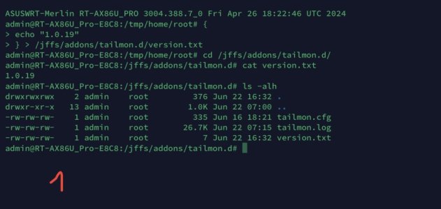

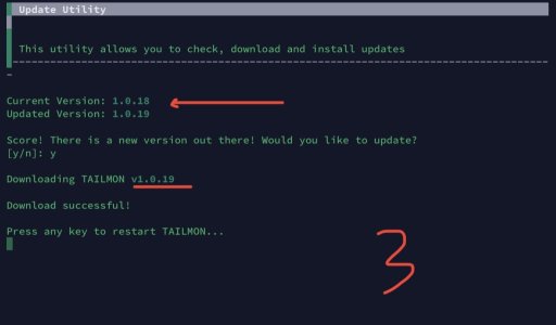

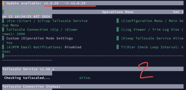

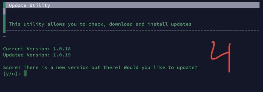

I ran update twice and after both times I’m still in 1.0.18. Updated version showing empty like last picture
I ran the command in the picture attached. It looks normal.
I would like to add that I’m connected to the device remotely through Tailscale and during the update processes and tailmon restart I was not kicked out of terminal/connection.
This is extremely unusual... :( Seems like your router both can't see github correctly to pull down the right version... and unable to write files under the /jffs/addons/tailmon.d subfolder structure. Are you seeing anything unusual in your syslog?
What happens if you try to manually create this file?
echo "1.0.19"
} > /jffs/addons/tailmon.d/version.txt
echo "1.0.19"
I don’t see anything unusual in the log file. Writing the txt file was unproblematic (the one which I deleted before). I ran the update (twice) and it says that it is downloading version 1.0.19 but I keep ending with 1.0.18 instead. What I only noticed is that in amtm update menu that amtm takes a bit longer to check updates for the scripts but everything’s runs normally I just need to wait a little bit longer.
