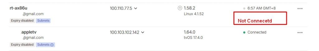

Hi Colin unfortunately my system seems to have a particular issue;
TLDR, it appears to install OK (with hiccups as below), but does not show as Connected (green dot) in the Tailscale admin (and it disconnects).
It used to stay connected.
I uninstalled and reinstalled entware to make sure I was starting from the same point as you.
It installed OK, started initially, then hiccuped at the 'advertise routes' line until I restarted /opt/etc/init.d/S06tailscaled start.

So per the pic I have added the Node to my subnet (I removed the old one to be sure I was starting from scratch) but it does not seem to be connected and it actually stops running?
xxxxxxx@RT-AX86U:/tmp/home/root# tailscale up
failed to connect to local tailscaled; it doesn't appear to be running
xxxxxxx@RT-AX86U:/tmp/home/root# /opt/etc/init.d/S06tailscaled restart

And this time the green connected dot appears; then disappears again.
@RT-AX86U:/tmp/home/root#  /opt/etc/init.d/S06tailscaled check
 Checking tailscaled...              dead.

Seems like it has a flaky connection that just won't stay connected.

I can report the same issue…
Installed as per instruction, but in a few minutes the connected dot goes gray…
