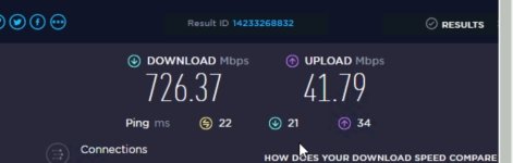

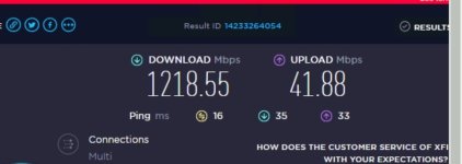

Just for some proof so no one thinks I'm losing it. Both speed tests run on same pc moments apart. Only difference one was done from the 2.5 g port the other from a gigabit port on router. No settings are changed all factory default
