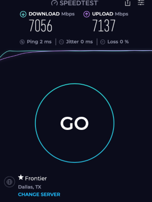

Yes, I just updated to the beta code, seems stable so far, my first impression is that the speed test degradation.
I was NOT able to get 7gbps up/down speed using this build. using OEM build I was getting 7gbps. Will test further.
Have you a 10 Gb Ethernet client to try the Ookla app?
There is no slowdown from the client side, I checked using my M2 Mac book pro using Thunderbolt to 10GBE ethernet adapter.
Getting full speed. So the issue is related to the router speed test.

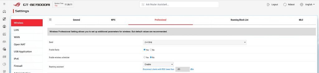

Set your 2,4GHz channel width to 20/40 MHz manually. That will give you a little extra distance. With a wifi scanning app, ( you can use apple airport utility, change setting to allow wifi scan) what is the RSSI of the router signal as measured by the phone ? Depending on what firmware is running on the router, you may be able to see the client device RSSI. It is likely the culprit as the radios are generally at lower power settings that you are not able to adjust.
I set it manually to 20 MHz and channel selection on auto. It seems that is better. I set the channel to auto because it has this interference detection that changes the channel if it gets some kind of interference. But idk if this function works properly or if it's better to set it manually and check for interference manually as well.
It was set to disconnect the device if the signal strength dropped bellow -70 and I set it to -80. I checked the signal and it's around -73. But this is something new for me so idk if it'll make any difference.
Any advice is welcome. Thanks

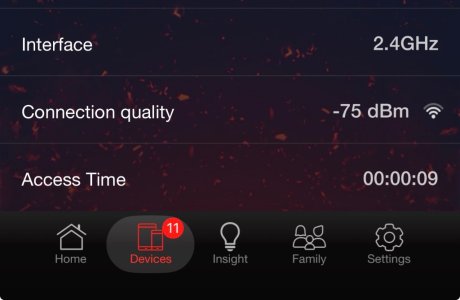

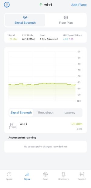

-73dB is a little low. But it depends on the area signal to noise ratio as to whether the client can talk successfully. You should be looking for better than -65 dB (a smaller negative number ).
Your last picture is for the 6GHz band, not the 2.4 GHz band. If you also look at the 5 GHz band, it should be a little better number, but probably on the weak side of what you want. You might consider a wifi extender that will reach cover that area at a higher bandwidth if you intend to use the 5GHz and 6 Ghz bands there.
Dropping a client at -70dB is a reasonable thing to do. Some do at -67 dB, some at -75. Bottom line is the client device determines when it wants to switch. Kicking it off (dissociating it ) the AP is trying to help that process, but even that doesn't always work.
Your low bandwidth numbers previously reported are probably from the client hanging onto the 2.4 GHz band at 20 MHz channel width. There is a tradeoff between lower channel width and distance reached. Lower width can reach slightly further.
Thanks for the info.
I believe that’s some kind of bug, the Asus app confirms that’s 2.4Ghz and my 6Ghz band is off.
I set channel and channel width to manual. It seems that’s normal with 50mb up/down.
I tested some routers before like the AX6000, AX11000 pro, GT98 pro and this new 19000ai has a weaker 2.4 GHz signal.
I was researching an online review and the only one available was the DongKnows. His review shows that the 2.4GHz performance at 40ft is one of the worst. Comparing all the routers above, this is actually the worst I've tested so far.
I'm not entirely sure how it works, but could a firmware update improve the range, or is it related to the hardware itself?
Thank you.
