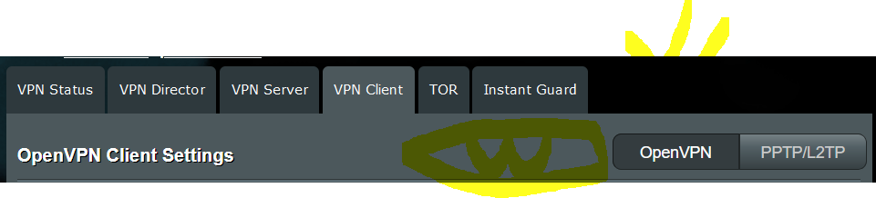

Good morning and bumping this thread. So is ultimately the goal for the merlin firmware to see a nice tab for wireguard here:
I think others have said this is a ways out and needs to have ASUS fully implement WireGuard first….
well...if you take the 8mo timeframe from RMelin earlier in this thread into account and the comment he made about asus migrating something code-wise on their side of things in relation to the current beta he's released (and now pulled), I'd say the 8mo is going to turn out to be just about right...give or take a few weeks either way.

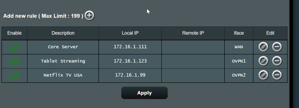

Suppose you have two OpenVPN clients and the VPN Director rules look like
Now if you create the equivalent WireGuard 'client' Peers wg11 and wg12, you can use the wireguard_manager command vpndirector clone
e.g.
e  = Exit Script [?]
E:Option ==> vpndirector clone
    Auto clone VPN Director rules
    peer wg11 rule add wan 172.16.1.111 comment Core Server
    [?] Updated RPDB Selective Routing rule for wg11
    peer wg11 rule add vpn 172.16.1.123 comment Tablet Streaming
    peer wg12 rule add vpn 172.16.1.99 comment Netflix TV USA
    [?] Updated RPDB Selective Routing rule for wg12
    VPN Director Selective Routing RPDB rules
ID  Peer  Interface  Source        Destination  Description
1   wg11  WAN        172.16.1.111  Any          VPN Director: Core Server
2   wg11  VPN        172.16.1.123  Any          VPN Director: Tablet Streaming
3   wg12  VPN        172.16.1.99   Any          VPN Director: Netflix TV USA
and the corresponding cloned rules (as shown) will be applied/used by the WireGuard 'client' Peers once the default Peer type is changed to Policy Rules using peer wg11 auto=p and peer wg12 auto=p
