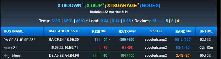

Wireless Report Wireless Report AiMesh v1.5.2 [2026-Apr-21] - WebGUI Table of all AiMesh connected devices (available in AMTM!)

<12>1 2026-04-21T12:01:53-04:00 rt-be88u Wireless - - [meta sequenceId="1155"] Report: [XT8DOWN] Kicking 16:67:22:16:E9:71 on wl1.1 (-71 dBm

Did it move to a better node and stay there?
