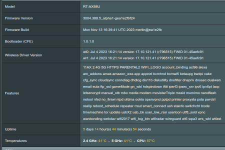

65H uptime for 160Mhz.

Never seen this Wireless uptime before!
90H of Wireless uptime in 160Mhz!
Woo-Hoo!
