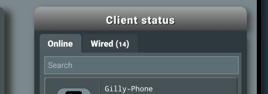

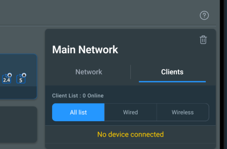

RT-BE88U with alpha2.
Network Map AND GNP showing no wireless devices connected. Specific to network map wireless devices are showing as "wired". Devices are connected in Wireless Log and I'm posting this from my connected phone.

Can you check if the aimesh tab in the router settings is loading up? I had a blank page when clicking the aimesh tab.
Blank page, just as you're seeing. "System Settings" loads but "Topology" is blank.
