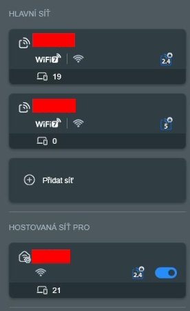

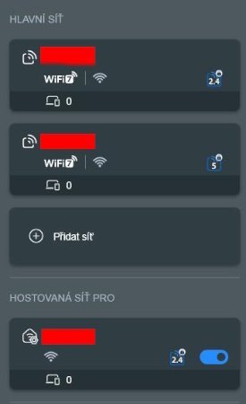

RT-BE88U with alpha2.
Network Map AND GNP showing no wireless devices connected. Specific to network map wireless devices are showing as "wired". Devices are connected in Wireless Log and I'm posting this from my connected phone.
Same problem. I don't have any WiFi devices shown. For me, everything is also like cable. RT-BE88U - alpha2.
Edit: Back to alpha1 - OK
