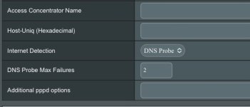

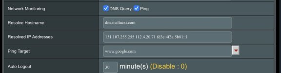

In the case of say dsl you have 2 options dns probe or ppp echo under WAN setting. I’m not sure how it detects if you run automatic ip for wan. Maybe verify you have the correct drop down option selected. And check under administration system you have detection setup correctly.
Only a real issue if it keeps persisting though.

On a side note, I have cable, not dsl and I don’t have ping or dns query enabled for network monitoring. It looks like if neither is checked, ntp is used which should work.
