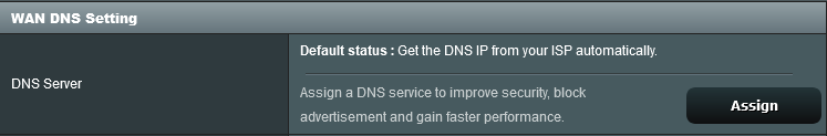

Just updated to "_alpha1-g9675d2e79d" and all went fine.
Discovered a new settings though.
Screenshot 2022-06-07 at 19-37-48 ASUS Wireless Router RT-AX86U - Internet Connection.png
Thank you RMerlin
A few months ago Asus implemented a preset list of DNS server. A few weeks ago they revamped it to make it more user-friendly by having a dedicated popup rather than a filled up dropdown with limited information. This isn't a new feature, just a redesigned interface to manage the WAN DNS servers.
