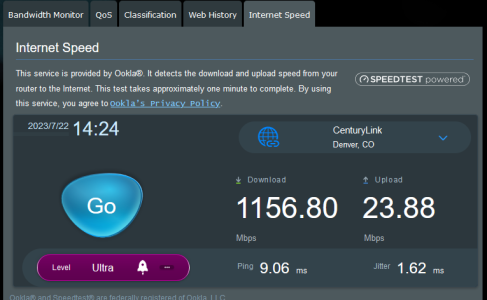

AX88U v1 388.4_alpha1 is working well.
Comcast 1.0Gb down, 20Mb up cable service, Modem LinkAgg to AX88U allows full throughput on the overprovisioned line typical of Comcast. No scripts running. Memory at 48%. Up for 26 hr. Sig for more.
