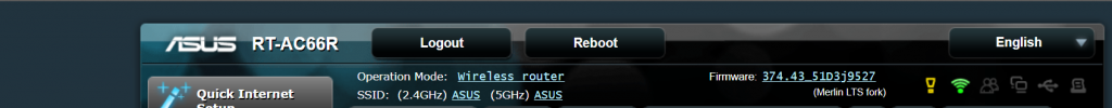

All set, successful with 51D3. Did full reset after that and all looks good. Will test it out on my network before passing it on.
Thanks for all the help!
