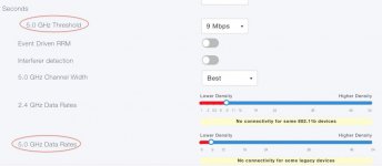

I have Cisco CBW240AC access points. In the controller software, Under Advanced RF Parameters, I don't understand the difference between adjusting the 5.0 Ghz Threshold (6,9,12 Mbps, etc.) vs. adjusting the 5.0 GHz Data Rates with the same selections, 6,9,12 Mbps, etc.
I'm not sure if the above tweaking will help me but this is what i'm trying to get out of it. Using only 1 SSID, I want to stay on 5.0 GHz as much as possible, disable the 2.4 GHz band in the trouble free areas (if possible) but I have some areas where I cannot get good 5.0 Ghz overlap so I want the AP to kick off the client from the 5.0 GHz band and push the device to the 2.4 GHz band, and use 2.4 band to either stay in that weaker area or use it until transitioning back to a good 5.0 GHz area.
If anyone can explain the difference and how it can help me out and/or how they're typically used would be helpful. I attached a screen shot of the config window.

@magic - Answers to your questions:
Threshold is the level of negotiated throughput between AP and client, below which the AP will send a BSS disassociation request (hopefully causing the client to roam). This setting allows you to "craft" client roaming behavior (at least minimally), as you can set the throughput value at which the APs will try to hand-off clients. A nice feature, presuming you have enough co-adjacent signal from a neighboring AP at any given location where the hand-off would be happening (that's on you as the wifi engineer to make sure that's the case).
Data Rate is the minimum level of client throughput offered by any/all APs. Excluding certain low data rates (used almost exclusively by legacy devices, such as those with 802.11b radios) helps to improve efficiency of the entire WLAN. It can also help with eliminating "sticky" clients from hanging onto AP connections for too long, causing excessive retransmits, resulting in hogged airtime and lowered performance of the entire WLAN. Be careful here, though, as getting rid of too many rates may not allow certain clients to connect at all. Long story short: I'd probably leave the slider at "9", maybe "12". For more info on this subject, here's a decent article: Why You Should Disable Lower Legacy Data Rates.
Hope that helps!
