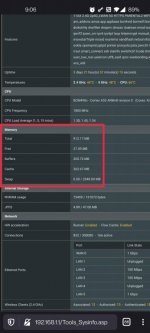

Is this normal or did I fudge somewhere? My Ram is full but swap file is not being used.
I have diversion, skynet, and flexqos installed.
My experience, for what it's worth, is that that high ram usage is a result of misconfiguration that can be seen as frequent errors in your system log. I had this in condition when I went from the 384 code base to the 386 code base without doing a factory reset. If I were you, I'd do a factory reset and slowly rebuild your router (painful, I know) starting with the simplest configuration and then adding complexity in small steps. As you add a component, watch the logs and the ram and be patient - the network uses tables and things populate slowly. Also, I'm somewhat leary of the swap file. I have a swap, but like you, I'm not sure it is effectively used. Anyway, after during a factory reset and being very cautious in configuration, I have a router that now runs with about 40 to 45% free ram.
Thanks, though I did exactly that when I flashed 381.1. Not saying I didn't drop the ball somewhere but hoping someone can help root cause without having to do it all over.
@Impaler614 don't overthink this. This is normal. The swap file will be used when it needs to be. And the RAM will be released to be used where needed (if needed).
