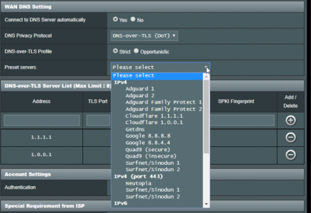

Missing Preset servers for DNS-over-TLS.
(Was there in Version 3.0.0.4.388.23110)
WAN > WAN DNS Setting > Preset servers.
Ref.
I also did try Factory Hard Reset.
I am still able to create a list (DNS-over-TLS Server List) manually.
Feedback sent to Asus through "Administration - Feedback". (Not sure if that is how bugs get reported here.)

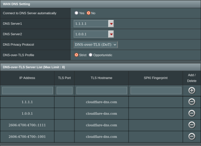

it is not missing, you just have to select "Connect to DNS Server automatically=No" and then choose the drop down preset at "DNS server1" and "DNS server2" each manually.
the UI changed and allow flexibility to mix and match between presets.

I understand that UI changed.
You are describing DNS Server. No issues there.
Specifically, DNS Privacy Protocol > DNS-over-TLS Server (DoT).
When it's enabled, Preset servers option is missing as in my included link for an image from
RMerlin thread here https://www.snbforums.com/threads/preview-asuswrt-merlin-384-11-with-dns-over-tls.56095/.​
Selecting those presets would populate DNS-over-TLS Server List (Max Limit : 8)

Internet Connection.png – is how it looks like right now, that list I had to populate manually. And Preset servers option is missing.
RMerlin DOT-preview2.png – shows Preset servers, how they were in previous version 3.0.0.4.388.23110
I understand it can be a bit confusing.
