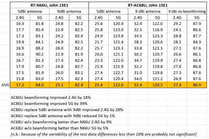

As an engineering professor for 34 years I have learned that in the scientific world anecdotal evidence alone is not enough. It must be backed up with measurements or it becomes a "my horse is faster than your horse" spitting contest.
My test setup cannot match that of Tim Higgins but I did my best to remove external variables. The router under test sits on a windowsill in my living room, and transmits through 3 panes of glass to a workbench in my garage about 75 feet away. This is enough distance that the peak speed of the WiFi connection is not the limiting factor and line-of-site communication minimizes reflections and other external influences. This is real-world in the sense that one of my goals is to get decent bandwidth in the garage.
So this afternoon I made 100 measurements comparing an RT-N66U with an RT-AC68U. I also compared 2.4GHz against 5GHz, and 5dBi antennas against 9dBi (advertised) antennas. Ten download Mbps measurements were made for each test condition and the averages computed. Both routers used John's fork 15E1.
The comparative results are more informative than the absolute numbers. These may look like speed tests but they are actually range tests because at a distance of more than 30 or 40 feet speed depends on attenuation, which in turn depends on range and intervening obstacles. Download speed is just an easily measurable parameter like volts or amps and it ensures that the router and the client device are not moved during the testing.
The greatest improvement was beamforming in the AC68U -- 39% better speed on 5G.
Next biggest was replacing the stock 5dBi antenna with 9dBi (advertised) -- 28% improvement on 2.4G.
Because of the variability of the test measurements differences smaller than 8 or 10% are probably not statistically significant. I'm not going to bother running a full statistical panel on these but from years of experience analyzing lab measurements that's a pretty good guess.
My 7-word summary from all of this is "turn beamforming on and use good antennas."

Your tests just prove the point too; all else being equal, the newer model usually gives the better (real world) results.
More interesting to me is the major gains of the newer model came from the beamforming feature. Without it the results were only about 5% apart, well within the probable margin of error. And there lies the advantage of systematic testing over anecdotal comments. I had hoped that the newer routers might benefit from better circuit design or higher quality fabrication, but without that particular feature there is little difference.
