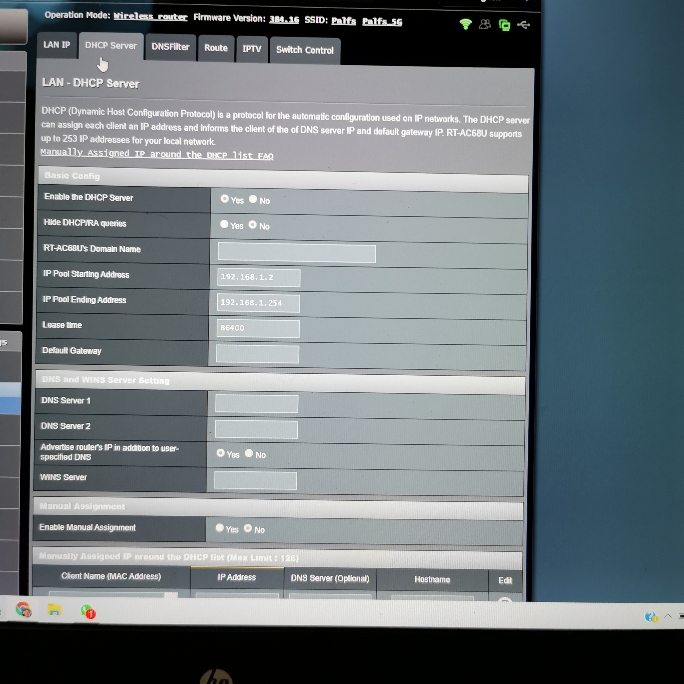

This is the config I used from the 68U (see image).
I didn't change any DHCP settings on the 86U.
Sent from my VOG-L29 using Tapatalk
The 86Us I've seen default to 192.168.50.1 on the LAN IP tab. So, the 86U DHCP server would use 192.168.50.2-254, by default.
Just make sure you are consistently using only one range of IP addresses (192.168.1.*) for both the router static IP (192.168.1.1) and the router DHCP server IP Pool (192.168.1.2-254).
