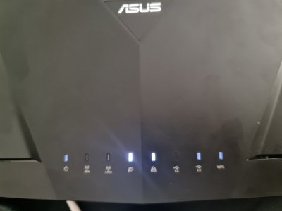

This is driving me up the wall as I've followed every possible method that Asus has provided to get this Router Going again.
I've got an ASUS RT-AC88U AC3100
I had it working fine and seemed to have been responding fine. In the Asus App on my app i noticed that there was a firmware update available for the router. so naturally I assumed right this sounds about right lets get this done it's a legitimate update from Asus no harm done here.
Well I was wrong there, as soon as the app began doing the firmware update I let it go and just walked away figured give the router some time to do it's thing. come back 2 hours later and find the router pretty much a paper weight.
all I see on the LED Indicator area is a really Dim light for the power status, A bright light for the ISP/WAN LED Indicator which is solid no flash. a slightly Dimmer Light on the Ethernet Indicator but still brighter than the Power LED light. & same as the Power status a really dim light for the USB 2.0 & WPS
And yes I've tried all these magical reset procedures that are scattered online, I've Tried everything the web had to offer apart from physically opening up the Router which I definitely do not want to go down that path.
I Am aware of the rescue mode that Asus offers as well but unfortunately I can't get it out of that bricked state it seems to be in.
What did you update from/to and how? This looks like a hardware issue to me.

I was connected to the router through the Asus router app that is available on the android store. Selected check firmware version. It said there was one available and I just continued on and set it go.

Thanks for the response
Yeah that's correct it was done via the official Asus router app from Google Play store
Ive left nothing plugged into the router at all powered it down for about an hour and back on and it reverted to the state I originally mentioned above.
Ive reset methods you offered in your response already
Oddly enough timed this but after 40minutes of being powered up and nothing plugged in. The routers wan and eithernet led indicator begin flashing non stop

If hard factory reset and recovery mode aren't working, it sounds like during the update it somehow died. Maybe some heat generated finally put a failing component over the edge or something. But I'd try the various resets and recovery mode again, and a previous firmware (if you can get to the point of uploading the firmware via recovery).
Yeah unfortunately, 24 hours worth of this headache, and couldn't get it to even get to recovery mode. I think it's essentially just killed it and it should be binned. It's pretty new I actually bought it from a friend who bought it for his gaming setup and never used it. It sat in the box for a while so I'm actually annoyed that I spent the money initially when I was warned against buying anymore Asus routers and they warned me about them just randomly failing entirely.
Not sure what to do and I don't know if I should bother buying another router or sending it in to an Asus service centre.

The fact that it seems to have bricked during a firmware update doesn't seem to point to hardware failure but stranger things have happened. My guess would be corrupted bootloader but that requires serial cable, taking the router apart, etc to troubleshoot.
If it is within warranty, may be worth the cost to ship it back, as even that router can handle 500M (potentially not if you use Aiprotection and some other features, but it is of limited value, and it would probably be able to hit 500 even with that on). A lot cheaper than a new one.
