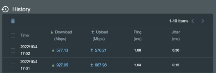

This is a bit weird....
Enabling WireGuard VPN after updating my AX86U drops down speed to half.
EDIT: Nevermind....found the problem - https://www.snbforums.com/threads/p...fig-file-on-gt-axe11000-w-388-firmware.80651/
It seems NAT Acceleration is off the table....so I guess going back to OpenVPN then. Bbay WireGuard....
Always best to not use a VPN client on the router if you want full bandwidth. Use the VPN on the PC, phone and etc.
