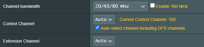

I think I have (had) a similar issue with some clients (5 GHz) iPhone's, iPad's not showing in the client list but they were connected (wireless log), reboot resolved it...
Also when I enable 160 MHz, at times the bandwidth goes to 20 MHz (slow), disabled 160 MHz and all good (80MHz)... did a factory reset but that issue is not resolved, I guess 160 MHz isn't that critical, only one of my clients (notebook) can use it...

It doesn’t work for me but 160 MHz in general is not a sure thing, right? DFS channels, radar… probably really depends where you are, we are close to an airport… so not sure if this is related to this firmware, having said that, Merlin FW made 160 MHz more available…

The 160 MHz working well here. I use the WIFI defaults except I turn off WPS and set the 2.4 GHz to 20 MHz. I have two AX and two AC clients that use 160 MHz. The router runs at 80 MHz most of the time but switches to 160 MHz when one of the 160 MHz clients connects. True, I do not need that high bandwidth but use it anyway because I can.
If you decide to try this firmware I would recommend a factory reset and manual reconfigure and a power cycle to clear old drivers from memory. Just give it a try. Really is good firmware.
