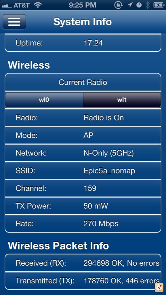

@connorm have you tried manually selecting a higher # 5ghz channel? Just curious.
I'm just curious what RSSI and/or connection speed all these people are getting that are reporting low speeds but using an Internet speed test as the only evidence of poor WLAN connectivity.
This is my Linksys E3000 running DD-WRT (DD-WRT v24-sp2 (03/25/13) mega - build 21061 ) as a media bridge connected to my RT-N66 (3.0.0.4.374.32 Merlinware) a floor below it. 5ghz radio on the N66 is running 110mw, e3000 running just 50mw I get 270-300Mb/s all day long.
And you are getting, or fearing DDOS attacks, with a dynamic IP? And if so, through the Asus's DDOS firewall? Is your router set *not* to respond to WAN pings? Is this coming in through a DDNS? If so maybe change DDNS, I found my NAS getting 20-30 login attempts per day (all from western europe/Asia/Russia) when I was using no-ip.org, but none since I use a different provider.
i think your confused, i never said i was having problems with speeds, generally where i can connect (especially to the 5GHz) i have good connection, and where i cant connect, i just cant, its goes from being good and able to connect to shirty and not able to, no inbetween really, lowest i seen 5ghz hit was 40mbps and that is to be expected at distance through walls, with good signal it gives me 90mbps pretty easy, and PLZ PLZ DO NOT refer to a sync rate as indication of my connection quality, i can be linked at 300N with a perfect signal feet from the router and not be able to cross 50 or 60 down, and even with a 1.3gbps sync rate its almost impossible to hit speeds of over 500mbps, with ssid insider the 2.4 GHZ will NEVER GET STRONGER THEN THE D LINK, i have my router set to the absolute max wich is 200tx even tho im fairly certain its barely putting out 1/4 of that, for 5GHz it always shows 450mbps but for 2.4 always shows 227 or something weird, i am using 20mhz tho, and im not ever going to 40 so plz dont say consider that, it will nto change range i am 100% positive, does anyone know what the max canadian TX is ? and also, some company filed a suit against asus a while back saying they put out to much power and then i read about how the code was changed so that the radio's on the rt-ac66u arent as strong anymore, and as far as i know that is the only router to have the nerf applied cause of the amount of power the router was consuming or something, and im pretty sure they wernt properly certified for that reason or something, but there next line of routers will be im fairly sure
