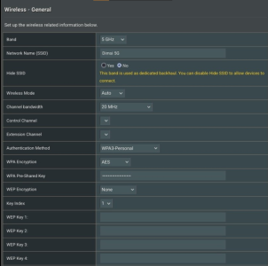

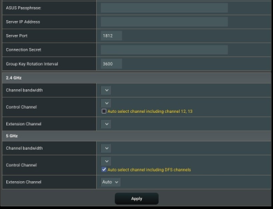

Just a little curiosity (somme may have long ago noticed ;)) that I managed to screen-capture while refreshing the WiFi General page... 😁
Just looks like a bunch of hidden (not user meant) FW settings :)
Nice little nugget. Seen it myself, a gentle reminder of bygone years. When was AsusWRT born?
Exactly! And this tells us the cleanliness of the code... 😅
Settings are shown/hidden based on model and configuration. For instance all these WEP field keys would appear if you had WEP enabled.
