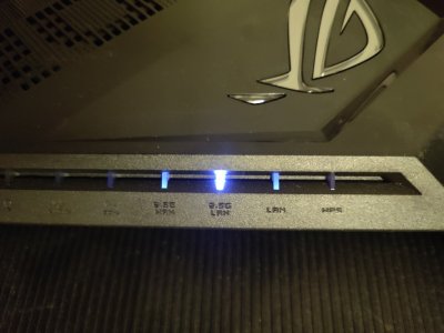

Running fine on my GT-AX6000.
Except for the 2.5G LAN led always on when cable connected but I have seen that reported earlier. The led is just on. Not blinking with activity or anything. Just shining away in the night, in my bedroom. 😂

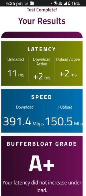

Also. Router won't even try to use 160 MHz. It just stays at 80 max. Before it at least tried.
