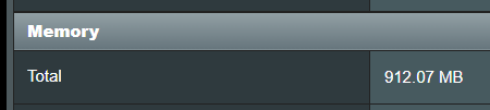

RT-AX86U - ~912 MB from 1024 MB
# grep "memory  :" /tmp/syslog.log*
/tmp/syslog.log-1:May  5 06:05:08 kernel:     memory  : 0xffffffc000000000 - 0xffffffc040000000   (  1024 MB)
Thanks! It seems that around 100MB of RAM is lost in some devices, but this has nothing to do with this release of Asuswrt-Merlin 3004.388.6. This issue may be discussed in a new topic.
Nothing is lost.
Simply different methods to count.
And, different methods to count from.
Nothing is lost.
I disagree, but as I mentioned, this is not the place for this discussion.
Not a discussion. Fact.
