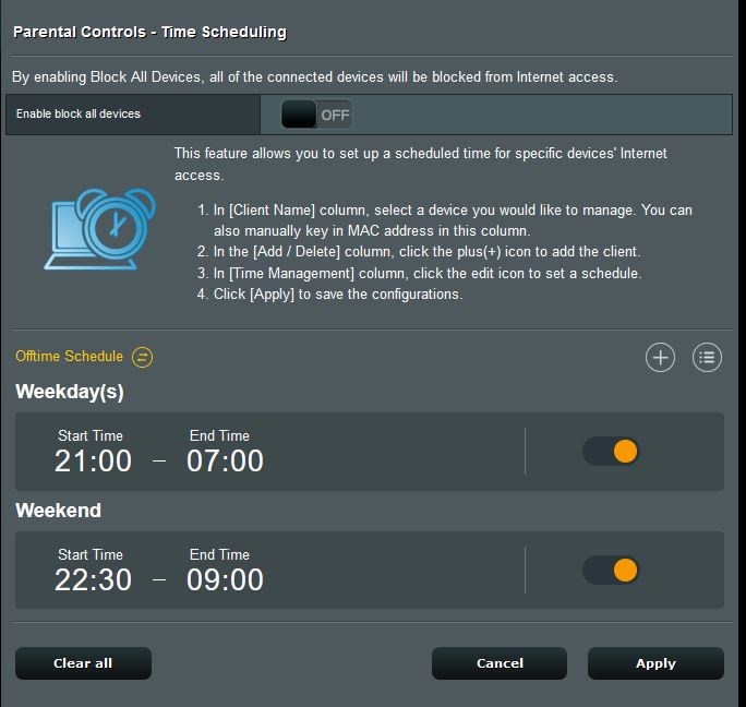

I'm guessing this is closed source and nothing can be done. But in parental control, I went to set up wifi times for kids. I put in a block time x to x, and it blocked it 24/7, tried changing to an online time from x to x, and it still blocked it 24/7. Had to disable it.
I played around with it to my son's annoyance and here it works.
