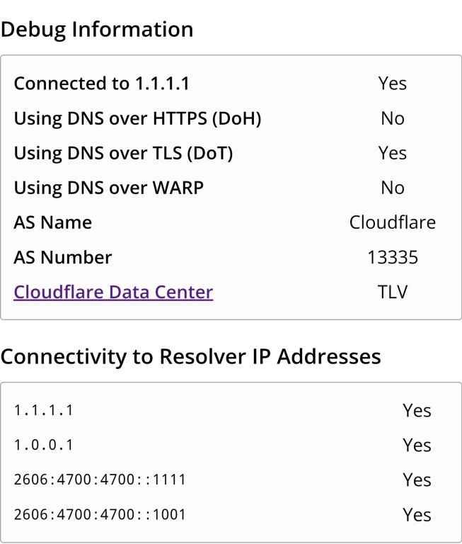

Update: DNSSEC back on
After enabling DNSSEC and configuring Firefox, now of most of the domains that were failing and causing the problem before, fail get this Yahoo! banner, the others just fail, but in either case nothing shows up in the logs
Thank You @RMerlin
