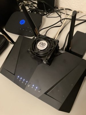

I have a fan on top of my RT-AX88U to pull air up and out. It helps a lot, enough to justify the cost (around $25). Just be sure to use an inductive ball bearing type for longevity and noise. If you use some non inductive (brushes) it could possibly generate enough electrical "noise" to affect the router. BTW, with the fan my CPU is running at 43c. Without the fan it ran at around 70c.

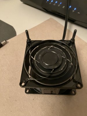

The fan I'm using is AC powered (110v) because I use the USB connector for a drive.
I've provided two pictures, one with the fan in it's running location, and one to show the bottom with screws and nuts to keep it from sliding down the router. The fan comes with the screws and other hardware. I got it from Amazon (like everything)
https://www.amazon.com/gp/product/B009OXTWZI/?tag=snbforums-20
Also, while the router is rated to run at high temperatures, I'm of the opinion that electronics simply degrade faster when run hot. I'm sorry if anyone else disagrees with me, but I am addressing a specific question with an answer. I think you'll see a temperature differential of around 25 degrees Celsius. I too am running an AX88U.
