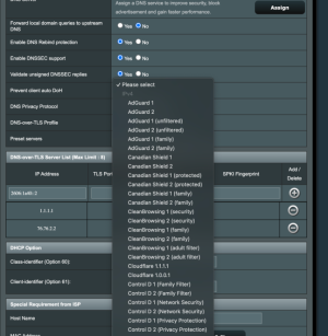

Is this correct? When I choose Control D 1 (privacy protection) under ipv4 I get the following. I see the same for the Network Secutrity ones as well. The Family Friendly ones show the correct ipv4 address though.
I can cofirm the mishap!
Despite praises for attention to detail earlier, I botched some copy/paste actions when trying to merge these from Asus’ own list. I’ll check this out when I’m back home later today.

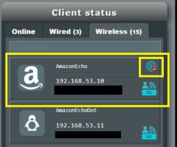

Where is it possible to "block internet access" in wifi clients in guest network, I can't find where?
You can block per Guest Network Pro Profile Client in the Parental Control > Time Scheduling section. Example attached. Don't see an option offhand to block Internet Access for the entire Profile all at once, at least on the Guest Network Pro IoT Profiles that I'm using.
PS: If the option to block all isn't available one could always using the firewall-start script file option to drop traffic via a script.
I've never found a way to block the Guest Network Pro clients via the Web other than to use the Asus Mobile App to block clients. I tried using your approach of Parental Control > Time Scheduling but it did not block internet access for the GNP client. Perhaps a bug? And for the record once set to Block within Parental Control there was no indicator of internet blocking on the Network Map > Client Status listing. There really should be a UI consistency when it comes to blocking clients, guest or not. Having to jump to the Mobile App or Parental Control for guest management is silly.

Using Parent Control > Time Scheduling does work fine for blocking. Yes, i did update to Beta3 but i think my earlier problem was i was trying to block the wrong MAC during my tests (the phones were using a Randomized MAC as opposed to what was reported in the drop down selection.
All I can say is that it works for me on a RT-AX86U Pro running 3006.102.4_beta3 as indicated by the prior screen caps posted to my earlier post. The Client Status entry for the Guest Network Pro client shows it clearly marked (via the icon) as disabled as indicated in my prior screen capture. The Guest Network Pro Profiles I have setup (two of them) are IoT. The profile was setup with the option Use same subnet as main network set to disabled so each of the clients gets an IP address in the 192.168.53.x range. I have manually assigned IP addresses for each of the Guest Network Pro profile clients (Advanced Settings > Manually Assign IP around DHCP list). I've tested in on two separate devices connected to the Guest Network Pro profile and the internet is blocked for both of them.
@RMerlin PR submitted to fix my mistake.
