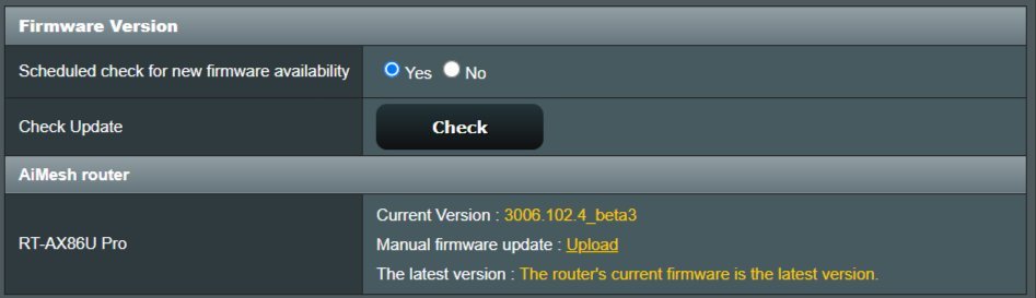

Edit to add: The firmware update check button is working on a RT-AX86U Pro running Beta3. When clicked it indicates it's checking for updated firmware then returns with "The latest version : The router's current firmware is the latest version." Might be something specific to the BE series, hopefully someone else with a BE series router can test the firmware Check button to see if it functions for them..

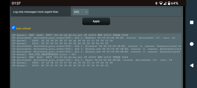

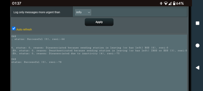

RT-BE98 Pro v2.0 running 3006.102.4_beta3. Minimal customization. 2 problems:
First problem: Pixel 8 Pro causes wifi radios to stop regularly when allowed to connect at 6GHz or 5GHz. Turning off its randomized MAC setting doesn't affect the problem. I have to restrict it to 2.4GHz. Incidentally, it has very low speeds on the higher frequency networks (comparable to 2.4GHz).
Second problem: Wifi 7 devices seem to like to sometimes show up on the client list as wired rather than wireless.
Screen shots of Pixel 8 Pro radio incident attached. MAC is 94:45:60:86:6E: E6.
Thank you for your work.
