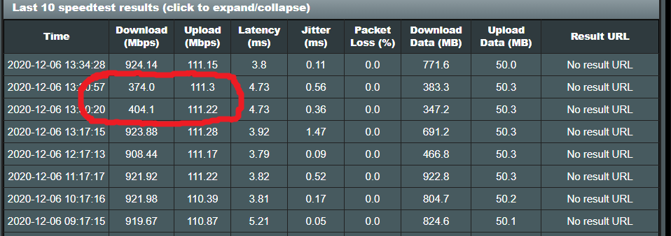

If anyone wants to point me in the direction of where the built-in speedtest binary lives in 386 I can make a version of spdmerlin to use that instead of the version I downloaded from Ookla, to see if it performs any better?
Not sure it would make a difference though.
I just compared spdMerlin, Asus's speedtest and Speedtest on my Desktop (Intel AX200) with my AX86U and a 1Gbps internet connection and here are the results:
However, this morning, I succeeded to get 950Mbps+ download speed with the Asus's speedtest...

BTW - if there's a slow down I mentioned it is both on CLI you are using and Asus Ookla page, so if Asus fixed it then it is likely for both. I will install beta in on the weekday to confirm
