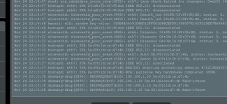

I had the same situation last night. Since upgraded my family says internet not stable, their phones getting no internet from time to time while other things still working. It happened to me last night also, I turned off WiFi on my phone and turned it back on. Once reconnected internet worked.
See attached log. Has anything looks strange?
