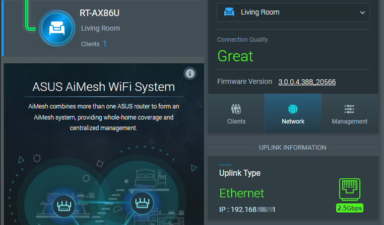

388.1 beta AX86U with AX86S hardwired node, ethernet backhaul only turned on.
If the node is on stock, AIMesh works fine.
If the node is on merlin, it reports as connection being severed, but still assigns clients there.
And the clients can still access the local network and internet right ? At least mine can with my twin AX86U mesh. Seems like a cosmetic / reporting issue rather than an actual connectivity problem.
I am seeing same between my two AX86U's which are hard-wired backhaul on the 2.5G port - but the connectivity is fine and port status graphic is green:
For recent Merlinware versions on at least the RT-AX86U "something" in his code has conflicted with AiMesh Node linking.
AiMesh is closed source - so I guess RMerlin has no way of determining what part of his code is causing the issue.
Solution is simple - just stick to stock firmware on all the AiMesh Nodes ... [ see mine pictured below on stock].
