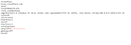

How does this wireguard vpn work? Need some help please.
I've imported a .conf file, I also see that I'm connected, but it is not working, see screenshot number 3.
Edit: Where can I set MTU for this wireguard client?
