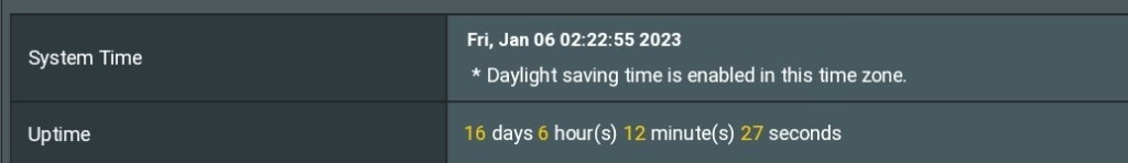

16 days in a row! Wooowooh!
Longest time in a long time, the WiFi is stable- everything is working.
Thank you for the firmware!
