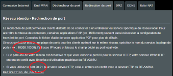

I found an issue on the Virtual Server / Port Forwarding page that crash the firewall service in the router (The issue is also there on the new version released today 386.5)
I have added the port for Moonlight 47984-47989,47998-48000,48002,48010
By mistake I have used the - instead of the :
If you add those port and reboot the router, you internet connection will never work (The firewall service doesnt work anymore).

What router model?
How did you manage to enter "47998-48000"? When I try to do that it refuses to accept the "-" character because it is invalid. Port ranges are denoted by ":".
I have an RT-AX88U and the - is allowed not sure why.
I'm also using Chrome 98.0.4758.102 if that help,
I can't recreate the problem here using Chrome on an RT-AX86U. But regardless of that the "-" character is probably the source of your problem as that is the wrong character. You should be using ":" as shown clearly on that page and in the FAQ.
I know that the : always worked well, this is the main reason why I created this thread to prevent other people to have the same issue
I just tested on an RT-AX86U the issue is also there
Here is the video
Thanks for the video. I see the problem now.
It's because you are using "cut and paste". For some reason this is allowing you to bypass the input validation on that field.
