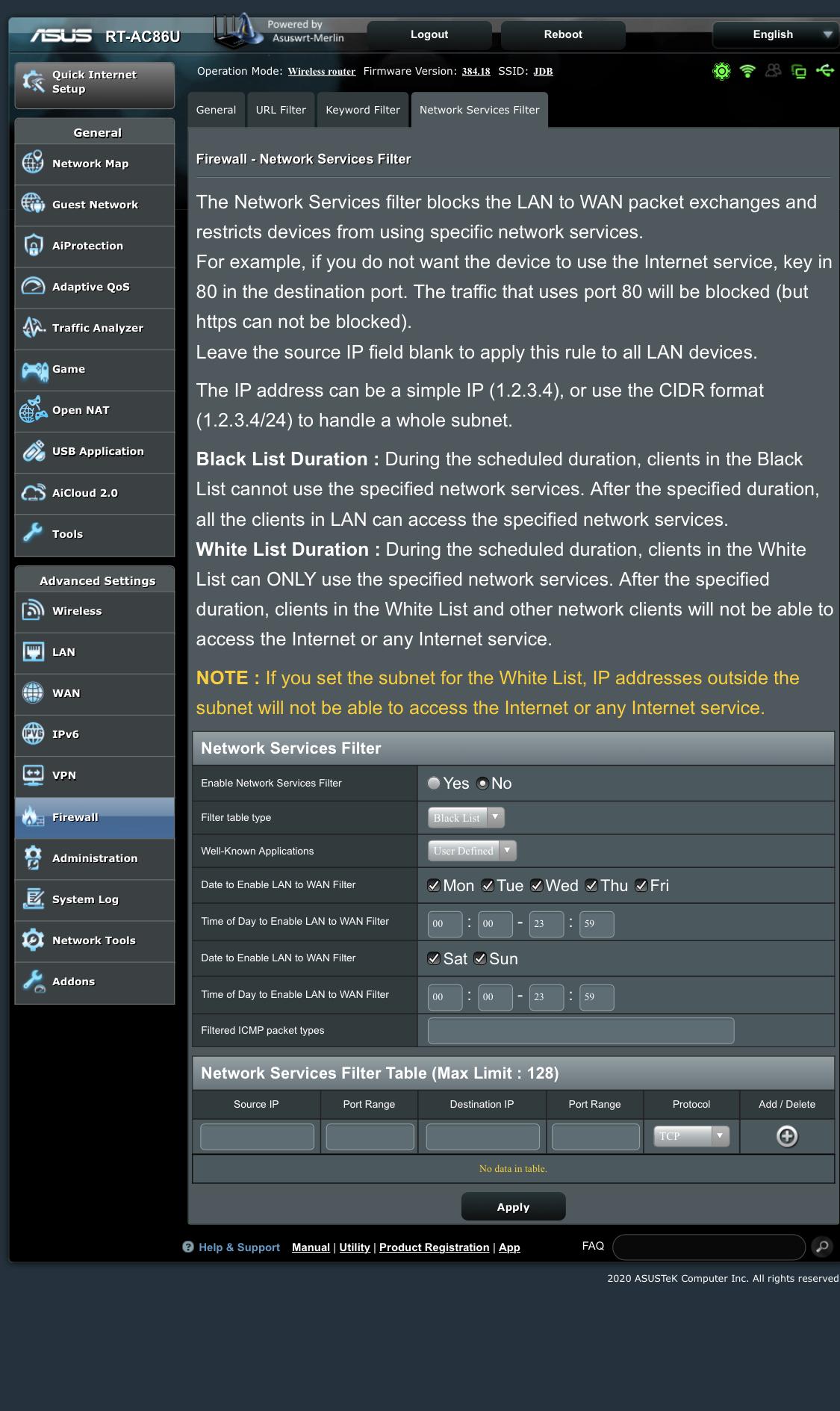

Could use the Network Services Filter to blacklist the IP’s you found that are bad

The network services didn't work for ea servers for some reason.
Ended up using skynet...as you know how to find the IPs it should be straightforward.
