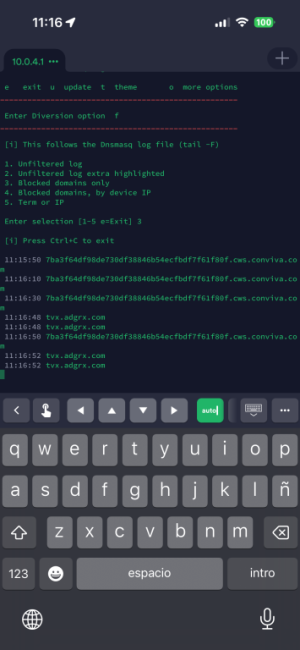

I’m having some issues with the whitelist. Especifically with this website tvx.adgrx.com. I’m unsure if other sites are being affected by this.
No matter if it’s included in the whitelist, diversion will block it in all devices. I have proceeded lists multiple times as well as rebooting router with no luck. I will appreciate your feedback on what could I be doing wrong.

Of course. I even forced an update just in case.
Log keeps showing that domain as blocked

You would need to whitelist adgrx.com instead of tvx.adgrx.com, since only adgrx.com appears in the big OISD list.
Another idea for @thelonelycoder would be to whitelist in a different manner. Instead of trying to match and delete from the blocklist, just force the whitelisted domain to resolve using the standard resolvers (saw this approach in Dirk Brenken's adblock on OpenWrt):
server=/tv.adgrx.com/#
@andresmorago You could try adding the above line to /jffs/configs/dnsmasq.conf.add as a test and see if the domain resolves properly.

@andresmorago You could try adding the above line to /jffs/config/dnsmasq.conf.add as a test and see if the domain resolves properly.
That should be /jffs/configs/dnsmasq.conf.add.

Thanks.
Adding it to the dnsmasq.conf.add helped. Domain now resolves correctly!
I will also check whitelist record and make sure it has its entire form.
