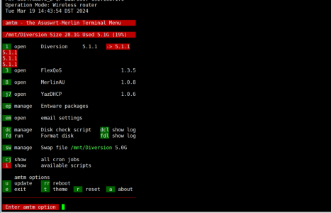

Would this indicate maybe my USB is going bad?
Issue was the internet slowed significantly and the router restarted on its on.
This is the output before it restarted. The screenshot shows how Diversion is showing now even after a force update.

Did you check AMTM->dcl?
Mar 19 12:52:10 init: USB partition unmounted from /tmp/mnt/Diversion fail. (return -1, Device or resource busy)
Do a reboot with dc enabled in amtm. See what it says after with dcl.
Thanks!
This is the output:
 Tue Mar 19 12:54:13 DST 2024 Waited 1s for NTP to sync date
 Tue Mar 19 12:54:13 DST 2024 Probing 'ext4' on device /dev/sda1
 Running disk check with command 'e2fsck -p' on /dev/sda1
 Diversion: clean, 515/1880480 files, 1496468/7515644 blocks
 Tue Mar 19 12:54:13 DST 2024 Disk check done on /dev/sda1
 Tue Mar 19 19:16:04 DST 2024 Waited 1s for NTP to sync date
 Tue Mar 19 19:16:04 DST 2024 Probing 'ext4' on device /dev/sda1
 Diversion: clean, 515/1880480 files, 1496617/7515644 blocks
 Tue Mar 19 19:16:04 DST 2024 Disk check done on /dev/sda1
 Tue Mar 19 19:18:50 DST 2024 Waited 1s for NTP to sync date
 Tue Mar 19 19:18:50 DST 2024 Probing 'ext4' on device /dev/sda1
 Diversion: clean, 515/1880480 files, 1496625/7515644 blocks
 Tue Mar 19 19:18:50 DST 2024 Disk check done on /dev/sda1
Not sure if the output helps at all and I'm also still seeing the same image from screenshot. I uninstall/reinstall for now but I will be replacing my USB soon.
