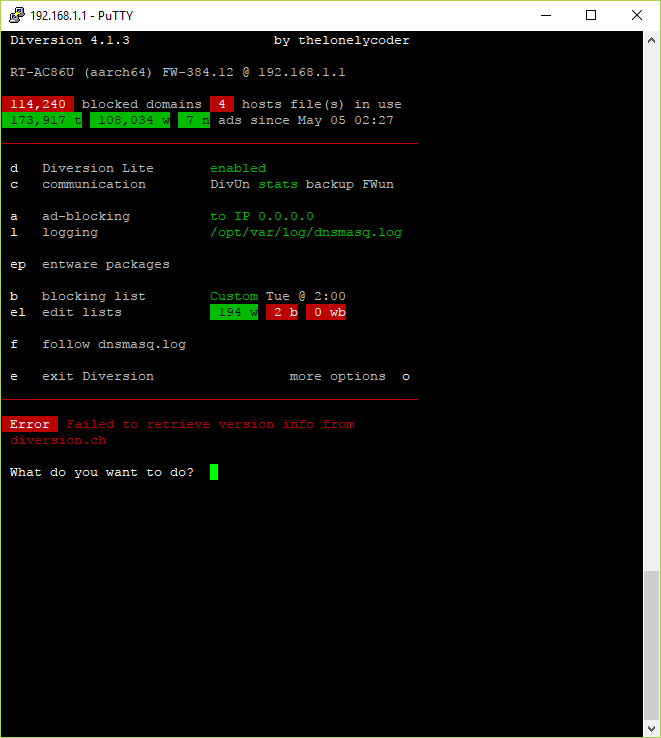

I updated both amtm and diversion without an issue. After updating, if I choose to update again (not that there is any reason to update since I have the latest), I noticed an error message printed on-screen. Attached are the two screenshots.
View attachment 18630 View attachment 18631
I figured out what the issue was. I had scheduled reboots nightly at 4am via amtm. When the router would come back online, it wouldn't sync with the time servers, and my time was May 5, 2018. As a result, I guess diversion could not check for updates (or amtm) given that the time was off by over a year. I manually pulled the power, plugged it back in, it synced with the time servers and worked correctly. Needless to say, I disabled the automatic reboots nightly...
