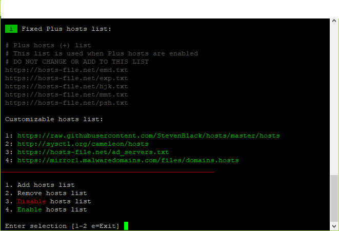

Quick, more accurate update of domains being blocked:
Small: 42,828
Standard: 116,172
Large: 178,454
Plus (+) Hosts: 494,886
Whitelisting should be very minimal, even using the "large" lists.
EDIT: Giving it a shot now. Let's see if I get any complaints in the household.

Why would a mirror be different than the master? Anyway that hosts list is dead, last changes were made end of 2017. That's ages ago for the fast changing times we live in.
But for some reason, the mirror is still being updated https://mirror1.malwaredomains.com/files/. Go figure. Unless I look at it the wrong way.
I got rid of https://zerodot1.gitlab.io/CoinBlockerLists/hosts
There are tons of legit domains on there, 49 belonging to coinbase, which is a legit website. So my "large" list keeps dwindling down, but seems pretty stable now. I did need to whitelist app.box.com else Box was broken. That's it so far though...
Also, a subset of that hosts file is already included in Steven Black's list.
